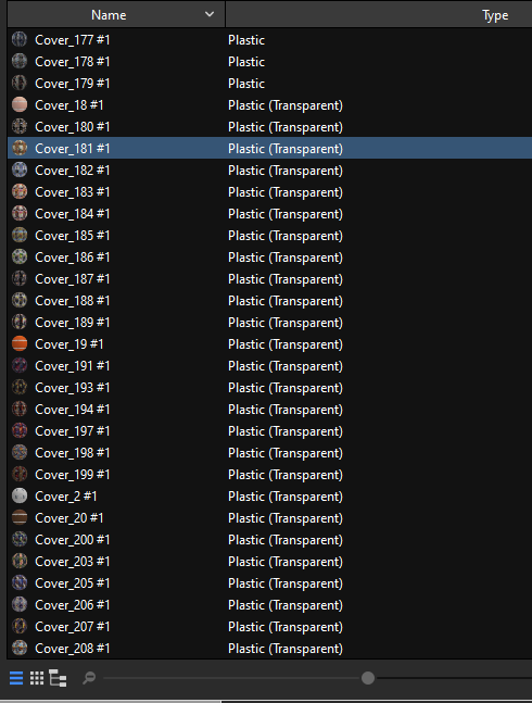

I used a scipt in 3DSMax to fill my book cabinet and imported the GLB which worked pretty well.
The only thing is that every imported material is of the Plastic (transparent) type which is not really needed and slows down rendering a lot. Especially since there are around 500+ different book covers so also 500+ materials.
It looks like this:
I need a way to change all Cover_### to the material type ‘plastic’. There are also some other prefixes but for the script that wouldn’t really matter, I can change it.
While I’ve tried a few things I can’t get my head wrapped around the Python scripts yet but maybe someone can kick me in the right direction. Changing them all one by one takes a bit long… I started :wink:

Thanks for trying! It would be nice if you could just select multiple materials and right click and change the Material Type. I noticed that if I export to GLTF the materials always get imported as Plastic (transparent). Not sure what causes it, could be because I do a scene conversion to get the V-Ray materials to a more PBR kind of material via 3DSMax.
If the material’s type ain’t reachable with a setValue I reckon it might be faster in the end to do them all manually. Or I’ve to check if I can do a different way of importing the books so the material will be plastic. Not sure if that will work since mostly with other formats the material is ‘diffuse’ which is also not what I want.

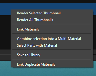

The simple workaround is to select all material (that should be changed) in the project material list and then use RMB “select parts with material”. Now RMB on one of the selected parts in the scene tree - RMB - material - change material type. DONE!
Wow @marco.wodarz, that worked like a charm. Scene was on pause here so perfectly in time. It will also help a lot in future scenes since I notice a lot of imported models get the plastic (transparent) by default after import.
Must say I would like the option to be in the material part as well, that’s also where I looked for the option. The selection of parts with the materials is useful but if you want to change a material type it has not much to do with parts.
Plenty of space in this context menu for ‘change material type’:
